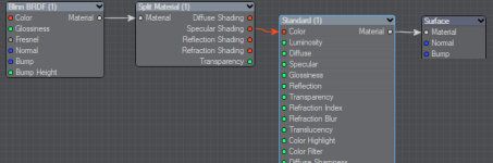

Whatever I try, I can't get anything but black output from any TrueArt's Node Library material nodes with LW2020.3.

What I am after is extracting the specular from a surface to use it as a mask for the same surface.

Why don't you make duplicate of the material and set everything except Specularity to 0%?
That's exactly what I wanted to do, but AFAIK material output doesn't provide a scalar output. That's why I tried with the Split Material node. But maybe I am missing your point...
