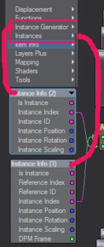

Hey Denis-- I got the same thing too. In layout, I add the DP INSTANCER (instance info) node to my setup (not DP INSTANCE instance info) and save the object. In the dropdown for your nodes in node editor, "instance info" node appears twice but they are DIFFERENT. One appears under "Instance Generator", the other under "instances"View attachment 118863. When I open the object in Modeler it gives me the warning "DP INSTANCER FAILED TO START" or something to that effect, and deletes THAT node, requiring that I add it again in layout when I use that object again. Any work around?
Thanks.
...When I open the object in Modeler it gives me the warning "DP INSTANCER FAILED TO START" or something to that effect, and deletes THAT node, requiring that I add it again in layout when I use that object again. Any work around?...
This has been fixed in the version 1.12 of DP Instancer (Windows versions)
Denis.
