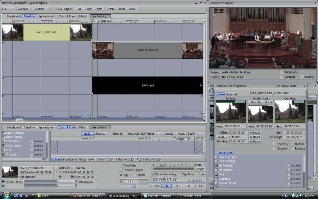

travisr
Multimedia Magician
I don't believe the bug that John fixed is the same bug I was seeing. I did my best to describe what I was seeing. It's nice to know that Scorpio recognized the problem from his experience in the past. Having two users share the same symptoms that can be reproduced seems to qualify it as a bug.
I've been able to state the problem. I've been able to state the conditions that cause the problem for me. I've been able to provide some details about my system. I've found someone else on here who could identify with the problem and who has experienced the same results. I appreciate the feedback from everyone, as I think this is a great community of support. But I'm not necessarily able to spend a lot of time thoroughly testing and filling reports. While I admit that would probably benefit me and others in the long run, I've got projects to edit and like many editors, when I find a quick fix, I will usually take that route in order to satisfy the client in a reasonable time frame. I feel like I've provided adequate information to help identify the problem and what is required to reproduce it. I was even able to determine the frame offset, and the fact that it is consistent.
Hopefully other people benefit from what I've learned, and maybe someone at Newtek will be able to wrap their head around the problem as well.

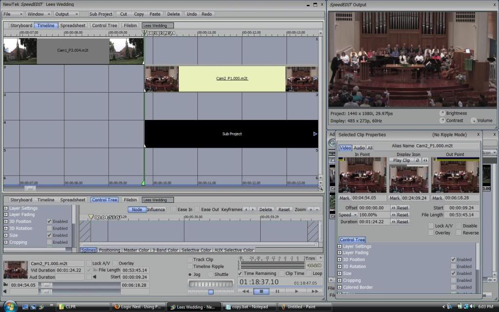

Working today and just found this same problem. I realize that this is a VT forum, however I believe the OP's issue is a SE bug not just on VT .
This also may be different since I am using 3 audio tracks grouped together in a Sub project. I have included screen shots so that everyone can see what's going on.
Please notice that the A/V lock is disabled on both vid clips.

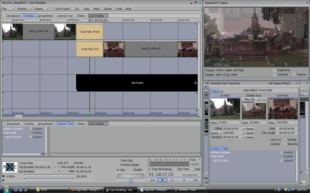

This is what happens after pressing ALT + F to add transition between these two files. Keep in mind nothing but these 2 files are selected and the audio in the subproject is not highlighted. The Sub-project is moved over by 15 and all audio following is also ahead by 15 frames.

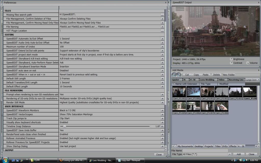

Here are the pertinent Prefs
I can get this to occur every time there is nothing ahead of the audio clip in question. Using ALT+F moves all audio that is not locked to a clip ahead on the timeline by 15 frames.
