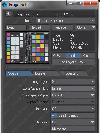

    This does work in Modo, as there it is possible to set a colorspace property to an image which overwrites the application’s default settings.
    In LW, this seems not to work: even when I set the Color Space RGB property in the Image Editor, LW does not handle images/textures with different colorspaces correctly.
    (2 texture files with the same effective color in color aware applications, but out of different colorspaces (aRGB and sRGB) don’t show identical colors in LW. However, they do so in Modo and any color aware application).

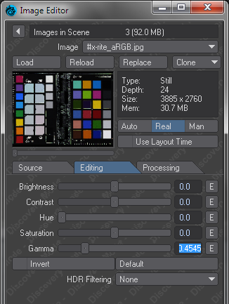

    As commented, working in wide gamut range is not possible with the Foundry config you refer in Modo, since what it does is to convert from wider gamut (let's say aRGB) to sRGB, which works for working in sRGB range with a wide gamut monitor. This same thing can be done within LW 2018 by loading sRGB-only images and using the LUT shared previously.

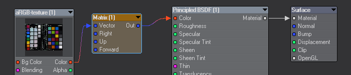

    If you want to mix sRGB with aRGB images in LW 2018, Node editor in Textured Filter should work in theory. Pitifully in practice, LUTs used there are not saved/loaded so the colorspace nodes within this editor is lost. Referencing the same image through TexturedFilter is also unstable, in the sense that you need to set things up in a specific order so that the color correction applied can be updated by Image Editor and it doesn't crash LW. I've tried also by using matrices instead of LUTs, and in spite of loading the node setup correctly, the ColorLayer node loses its image reference every time the scene is loaded. Using a clone instead and saving objects and scene again doesn't work either because it seems there's a bug in v2018 where cloned images are not loaded. Maybe you could confirm if this bug has been already solved in last v2018.3 (I haven't checked yet). These limitations are not present in v2015 with DP Image Filter Node Editor, nor with SG_CCTools. This is why I commented in my first post that in v2018 you need to pre-manage your input colors externally in a CM-aware software.
    Gerardo

    Actually, I’m not sure about this, as I’ve made a test which resulted in strange color rendition in the shadows area, which seems to be clipped and which introduces a magenta color cast.
    Using the standardized „AdobeRGB 1998” ICC profile seems to work better, but the profile is often lost when reopening a scene which is using it.
    (I’ve attached 3 results with combined aRGB and sRGB texture files).

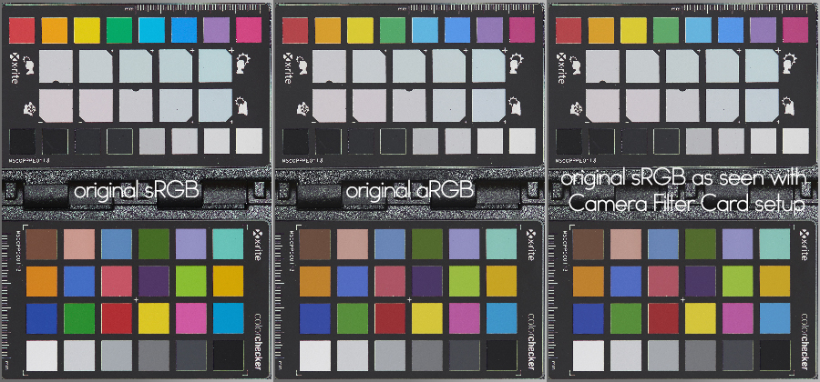

    hmmm... aRGB LUT works fine here, look:
    Sorry for not being clear enough when I said "just use it instead of display sRGB space in v2018", with just I meant only as display space. Do not use it for linearization in Image Editor. There are 2 reasons why you should not do this:
    - First, you are cancelling the conversion in order you can display proper sRGB colors in your aRGB monitor.
    - Second, better use the native sRGB profile. Not only because the images are encoded with sRGB curve but also because the shared cube is just a 36x36x36 3D LUT and you'll get such ugly posterizations with such low resolution if you use it for linearizations.
    To give you an idea, the LUT performing linearization in OCIO is a 4096 res 1D LUT. We need a lot of table entries to avoid quantization for linearizations, and even for gamma correcting, a 36 res LUT is not enough in this case (there's indeed a darken results in shadows due to LUT precision). This is why is better to use the sRGB profile instead, which is a parametric solution. This is the reason why I said previously that gamma curves are better solved with an actual gamma function instead of a LUT. There's 2 or 3 ways to avoid quantizations in LUTs, but none of them are supported by LW yet. However there is another option to solve the issue I'm gonna show you later.
    Btw, I can notice that, same than with PC, MAC version of LW displays ICC profiles with pinkish colorcast. Hope they solve it eventually.
    Anyway, since you are using the LUT for linearizing the image, you are cancelling the proper conversion. Original image chromaticities should be kept intact in this case, otherwise you'll get back sRGB colors instead of aRGB colors (besides posterizations) and colors obviously won't match with aRGB reference.
    Do not expect also colors matching up perfectly with aRGB reference, since aRGB gamma curve and sRGB curve are different. So you would need to compare against same curve. Also if color data is originated in wider gamut (and depending on the saturation of sampled colors), you won't be able to recover original gamut if it was previously converted to a smaller one unless some kind of gamut expansion is performed. Thing you can not do in Modo, but it can be done in a CM-aware software.
    So in order to address same curve than sRGB but with aRGB chromaticities, you could go in another way. Think this is my first little tut for LW2018
    - Go to CS panel and set sRGB preset (the correct v2015, not the incorrect v2018).
    - Then switch display from sRGB to Linear.
    Now, instead of using the display parameter from the CS panel, we are gonna use the gamma correction trick I shared for FPrime in a magazine long time ago, which also works with VPR as described here, btw:
    http://forums.newtek.com/showthread....=1#post1337325
    In order to update the trick for v2018 we need to go in this way:
    - add a plane/card and parent it in front of the camera:
    - Switch to Standard Material and set 0% diffuse / 100% luminosity
    - In Surface Node Editor connect RayPosition and RayDirection from Input node to respective Postion and Direction inputs in RayTrace node.
    - Add 2 ConvertColorSpace nodes. Connect raytrace color output to the first ConvertColorSpace node and set at sRGB colorspace (this is our parametric curve) and the next one at aRGB-sRGB LUT (this could be also a matrix) and connect this concatenation to Color Input of Standard material. I'm attaching the aRGB-sRGB LUT.
    - Finally, enable RayTrace Refraction.
    That's all. You can see here how colors macth up:
    Nice thing about this solution is that we are leaving display for what it really is, just display. So for example, we can simulate a log output and and a filmic display. in this case I'm emulating a filmic TMO:
    We can emulate different print density films in the card and theatrical films in display. Ideally, this should be done in an Image Node Editor, like we can in v2015 with DP Node Image Filter, where we can do even a lot more things.

    hmmmm... The setup looks well here, look:
    The setup with the aRGB display really match the aRGB original, which is of course less saturated than the sRGB input. Just in case, be sure you are not using the Removed output instead of the Applied one (which would invert the table and saturate the results instead). If you want, you can attach your scene file and I can check here if I get same results than yours. If I get the same results I'm getting here, it means it's something in the way your OS is configured. If not, then it might be something in your scene setup.

    This is my second little tut for LW 2018
    In order to work in sRGB space with an aRGB monitor by mixing images originated in both (aRGB and sRGB) colorspaces, just use the Camera Filter Card setup I shared previously. It's the same process so I won't repeat it here. Then:
    - For every aRGB image in Image Editor, switch colorspace from sRGB to Linear. (aRGB curve for images is not sRGB curve but 2.2 gamma curve)
    - Then in Editing tab, set the proper gamma linearization value in gamma parameter: 1/2.2
    - Finally in Surface Node Editor, use the attached matrix every time you use an aRGB image for building a shader or material.

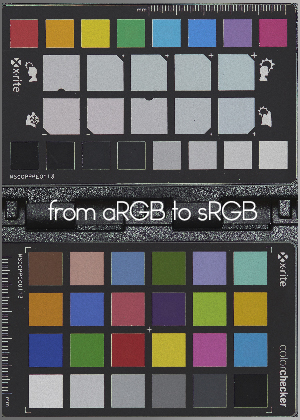

    That's all. And as we can see, it's working:
    (it's not apparent but I'm using the mask here to separate original sRGB from transformed aRGB color patches)
    Surprisingly, results match up better than what you got in Modo!

    That's all. this is the matching we got:
    We can notice results are a bit more contrasted because we are previewing with the sRGB curve instead of 2.2 gamma. If you want a 2.2 gamma preview just set up a gamma correction with the Camera Filter Card rig instead.
